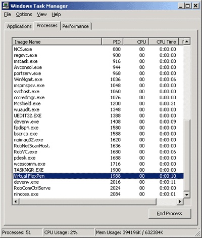

Windows Task Manager
You can also attach a running application through the Windows Task Manager.
Step
1
Start Windows Task Manager and select the Processes tab.
windows task manager
2
Select the Virtual FlexPendant.exe process and right-click to get the context menu. In that menu select Debug. You will get a warning message, but select Yes.
3
A Just-In-Time Debugging dialog will appear. Select your application project as the debugger to use.
