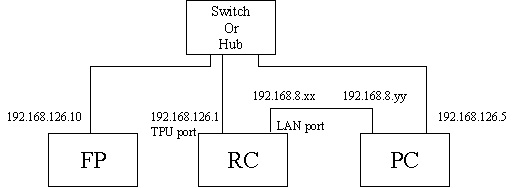

This illustration shows how to connect the FlexPendant, the Robot Controller and your PC in order to debug your application using the Visual Studio debugger.
setting up network
The FlexPendant has a static IP address 192.168.126.10. Your PC IP address must be one on the 126 subnet, that is, 192.168.126.x (not 1 or 255).
Note that this setup is completely independent of the LAN and Service ports. You are plugging the TPU cable from the RC into the switch, a cable from the switch to the RC, and a cable from your PC to the switch.
A connection over the LAN port is optional, but useful, as you may need to use RSO or FTP at the same time. To use both connections, your PC requires two NICs.

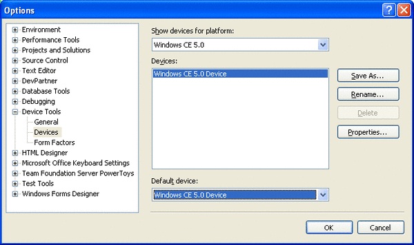

On the Tools menu in Visual Studio 2005 click Options .
2
In the Options dialog expand the Device Tools node and select Devices. Select Window CE 5.0 Device as shown in the following screenshot.
options
Note Note
If your FlexPendant version is SxTpu1 the option Windows CE 5.0 Device is not available. Instead you should select Pocket PC 2003 Device.

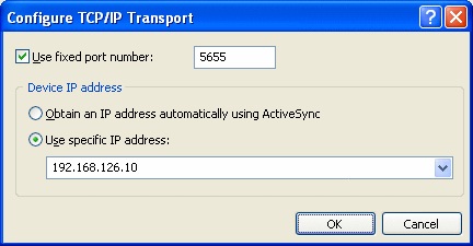

Apply the settings shown in the picture.
configure tcp

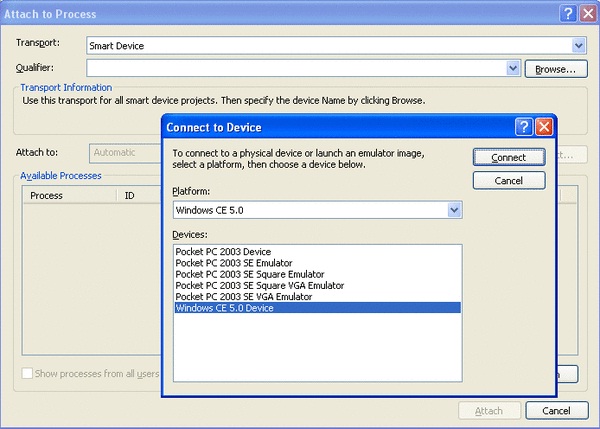

On the Debug/Tools menu in Visual Studio click Attach To Process. In the Smart Device dialog select for Transport and click the Browse button to specify platform and device. Then click Connect.
connect to device
6
In the Available list select taf.exe Click Attach.
