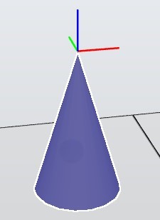

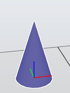

    This example provides information on modifying the local coordinate position and orientation of a Part.
    Before Local Origin Change
    Before Local Change
    After Local Origin Change
    After Local Change
