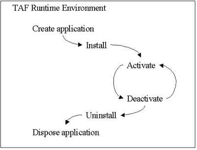

Application life cycle
TAF handles the life cycle of a custom application, starting by calling the constructor of its TpsView class. After this, the Install method and then the Activate method in the same class execute.
During its lifetime, the application switches between the active and the passive state. Each time, either Activate or Deactivate is executed. In its active state the application is visible in the client view, in the passive state another application may have been opened or you may have opened another application through the FlexPendant task bar.
When the application is closed via the close button, first the Deactivate method runs and then Uninstall. After this the Dispose method of the TpsView class is called. Then the application instance is disposed of by TAF. For more information about how you can implement these methods, see ITpsViewSetup and ITpsViewActivation.
Illustration
The figure illustrates the life cycle of a FlexPendant application.
Lifecycle FP
