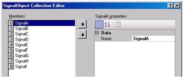

  2. The SignalBindingSource in the application’s Test view depends on the existence of 9 do signals and will not work without these:
    Signal Object Collection Editor
    Note Note
    A Digital Output named doActive is also necessary.
    In FlexPendant ControlPanel – Configuration load the included cfg file, which creates all the signals needed.

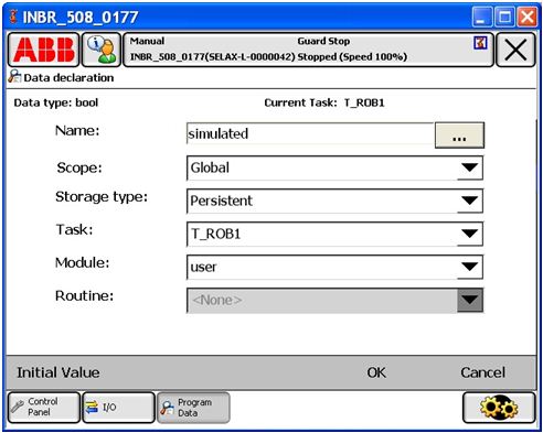

  3. Create RAPID data as specified:
    Global Persistent RAPID data "simulated" of data type "bool" in task "T_ROB1" "user" module". Initial value: false.
    Global Persistent RAPID data "cycles" of data type "num" in task "T_ROB1" "user" module". Initial value: 0.
    INBR 508 0177data Declaration
    Note Note
    Storage type must be Persistent!

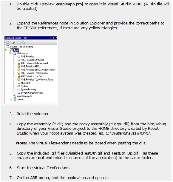

  5. Build the sample application and have it started on the FlexPendant.See procedure below:
    Build And Start
  6. Set up and use the Visual Studio debugger to step through the code as it executes on the virtual or real FlexPendant, i e set a breakpoint in the event handler of a UI Button for example and see what happens when you click it. See User’s Guide and the User Forum to find out how to test and debug a FlexPendant application.
