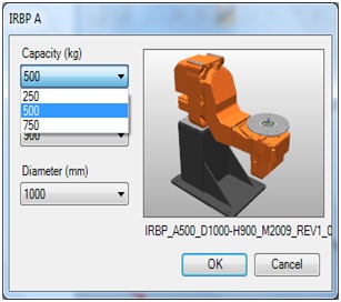

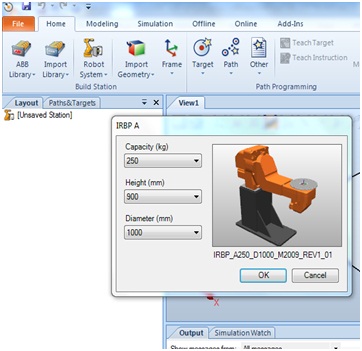

    This ends up in 13 variants for IRBP A. Each variant is a separate library and is specified in its own .rsxml file. In the sample this can be seen from the file naming convention. The file LibraryTemplates.xml is used by the Library Gallery in RobotStudio in the following way. All variants are represented by one item in the gallery (IRBP A).
    When this item is selected by the user, a dialog is rendered by RobotStudio, based on this XML file, and each variable parameter is presented as a combo box.
    IRBP A comes in three handling weights 250, 500 and 750kg. There will be different combo boxes to select different variants.
    The 500 and 750kg version comes in three different heights 700, 800 and 900 mm.
    The 500 and 750kg version comes in two different diameters 1000 and 1450 mm.

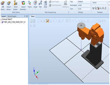

    Depending on the choices on the combo boxes, the specific library will be selected and opened in RobotStudio.
