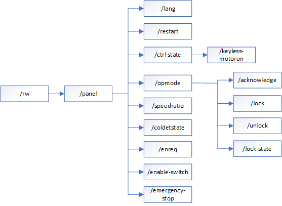

openapi: 3.0.1 info: description: | Panel Service ![Panel resources](/api/RWS/Swagger_Doc/images/panel.png) version: 3HAC073675-001 Revision:L title: Robot Web Services tags: - name: Controller Language Settings description: '' - name: Restarting Controller Options description: '' - name: Controller State Activities description: '' - name: Actions on Controller-Operation Mode description: '' - name: Speed Ratio Control and Retrieve description: '' - name: Collision Detection Activities description: '' - name: Enabling Device Requirement description: '' - name: Toggle Enable Switch description: '' - name: Controller Stopping Options description: '' components: requestBodies: RequestBody: content: application/x-www-form-urlencoded;v=2.0: schema: type: object required: - state properties: state: description: on | off type: string example: state=string description: Data parameter(s) securitySchemes: basicAuth: type: http scheme: basic servers: - url: https://127.0.0.1 description: Localhost VC - url: https://192.168.125.1 description: RC MGMT connection paths: /rw/panel: get: tags: - Panel Service Listings summary: Get Panel Resources description: > **Description :** Get a list of panel resources. **Pre-requisites :** None **Limitation :** None **Sample Curl Call :** curl -u "Default User":robotics -H "accept: application/xhtml+xml;v=2.0" "https://localhost/rw/panel" **Example java script :** ``` const https = require('https') process.env.NODE_TLS_REJECT_UNAUTHORIZED = "0"; //provide the user id and passowrd let encoded = Buffer.from("Default user:robotics").toString('base64') var auth = "Basic " + encoded; const options = { hostname: 'localhost', port: 443, path: '/rw/panel', method: 'GET', headers:{ 'Accept': 'application/hal+json;v=2.0', 'Authorization': auth } } const req = https.request(options, res => { console.log(`statusCode: ${res.statusCode}`) res.on('data', d => { process.stdout.write(d) }) }) req.on('error', error => { console.error(error) }) req.end() ``` responses: '200': description: Standard response for successful HTTP requests content: application/xhtml+xml;v=2.0: schema: properties: pnl-ctrlstate-li: description: The controller state resource pnl-opmode-li: description: The Operation mode resource pnl-speedratio-li: description: The Speed ratio resource pnl-coldetstate-li: description: The Colision detection state resource ctrl-state: description: controller state information {motorOn | motorOff} opmode: description: operating mode of the controller {manual | auto} speedratio: description: speedratio in which the controller is operating coldetstate: description: >- The collision detection states {INIT | TRIGGERED | CONFIRMED | TRIGGERED_ACK} pnl-enreq-li: description: The Enabling device resource xml: name: data wrapped: true examples: response: value: |
