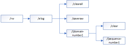

paths:
/rw/elog:
get:
tags:
- General Elog Service Actions
summary: Get Elog Resources
description: "**Description :** \n\n\"Get a list of all elog domains. \nAlso supports getting the number of events in each domain and language specific names of the elog domains.\"\n \nThe current list of elog domains with short description is as below:\n\n \n+ **Common :** Contains the events from all logs (except \"Internal\", \"Configuration\" and \"RAPID\").\n \n+ **Operational :** Events dealing with handling of the system.\n \n+ **System :** Events dealing with system functions, system states, and so on.\n \n+ **Hardware :** Events dealing with system hardware, manipulators as well as controller hardware.\n \n+ **Program :** Events dealing with RAPID instructions, data, and so on.\n \n+ **Motion :** Events dealing with the control of the manipulator movements and positioning.\n \n+ **IO & Communication :** Events dealing with inputs and outputs, data buses, and so on.\n \n+ **User :** Events defined by the user.\n \n+ **Safety :** Events related to functional safety.\n \n+ **Internal :** Internal events for debug and service.\n \n+ **Process :** Application specific events, arc welding, spot welding, and so on.\n \n+ **Configuration :** Events dealing with the configuration of the system.\n \n+ **Paint :** Events related to Paint application.\n \n+ **RAPID :** RAPID build error log.\n \n+ **ConnectedServices :** Connected Service Embedded event logs which are generated during starting, registering, unregistering, losing connectivity, and so on.\r\n\n\n**Pre-requisites**: None\r\n\n\n**Limitation**: None\r\n\n\n**Sample Call**: \n\n curl -u \"Default User\":robotics -H \"accept: application/xhtml+xml;v=2.0\" \"https://localhost/rw/elog\" \n\n curl -u \"Default User\":robotics -H \"accept: application/xhtml+xml;v=2.0\" \"https://localhost/rw/elog?lang=de\" \n\n\n\n**Example java script**: \n```\nconst https = require('https')\nprocess.env.NODE_TLS_REJECT_UNAUTHORIZED = \"0\";\n//provide the user id and passowrd\nlet encoded = Buffer.from(\"Default user:robotics\").toString('base64')\n\nvar auth = \"Basic \" + encoded;\nconst options = {\n hostname: 'localhost',\n port: 443,\n path: '/rw/elog',\n method: 'GET',\n headers:{\n 'Accept': 'application/hal+json;v=2.0',\n 'Authorization': auth\n }\n}\n\nconst req = https.request(options, res => {\n console.log(`statusCode: ${res.statusCode}`)\n res.on('data', d => {\nprocess.stdout.write(d)\n})\n})\nreq.on('error', error => {\n console.error(error)\n})\nreq.end()\n```\n"

/rw/elog/clearall:
post:
tags:
summary: Clear Elog Messages
description: "**Description :**\n\n \"Clears all elog messages in all elog domains (except Internal).\"\r\n\n\n**Pre-requisites**: None\r\n\n\n**Limitation**: None\r\n\n\n**Sample Call**: \n\n curl -u \"Default User\":robotics -H \"Content-Type: application/x-www-form-urlencoded;v=2.0\" -X POST \"https://localhost/rw/elog/clearall\" \n\n\n\n**Example java script**: \n```\nconst https = require('https');\n //To disable SSL\n process.env.NODE_TLS_REJECT_UNAUTHORIZED = \"0\";\n const userId = process.env.USER_ID || 'Default user';\n const password = process.env.PASSWORD || 'robotics';\n let encoded = Buffer.from(`${userId}:${password}`).toString('base64');\n var auth = \"Basic \" + encoded;\n\n const options = {\n \t hostname: 'localhost',\n \t port: 443,\n \t path: '/rw/elog/clearall',\n \t method: 'POST',\n \t headers: {\n \t\t 'Accept': 'application/hal+json;v=2.0',\n \t\t 'Content-Type': 'application/x-www-form-urlencoded;v=2.0',\n \t\t 'Authorization': auth\n \t }\n };\n\n const req = https.request(options, res => {\n \t console.log(`statusCode: {res.statusCode}`);\n \t let responseBody = '';\n \t res.on('data', d => {\n \t\t responseBody += d;\n \t });\n \t res.on('end', () => {\n \t console.log(responseBody);\n \t if (res.headers.location) {\n \t\t console.log(res.headers.location);\n \t }\n \t });\n });\n\n req.on('error', error => {\n \t console.error(error);\n });\n\n req.end();\n```\n"

/rw/elog/saveraw:
post:
tags:
summary: Save Elog in System Dump Format
description: "**Description :**\n\n\"Save event log in system dump format on controller. Location header /progress/{id} will be returned after successful completion of the API.\nSince saving an elog in system dump format is an asynchronous task, the value of location\nheader can be subscribed on to get information about the status of the task.\"\n\nThe resource can be subscibed to get events with current status of saving elog. \nThe resource URI for this subscription will be /progress/{id}, where /progress/{id} \nis the\"location header\" returned after successful completion of \"Save elog in system dump\nformat\" API. \n\nSample responce for CFG Load subscription\n\n \n \n \n \n \n \n \n \n \n \n An event will look like\n \n \n \n \n \n \n \n \n \n\n\n\n**Pre-requisites**: None\r\n\n\n**Limitation**: None\r\n\n\n**Sample Call**: \n\n curl -u \"Default User\":robotics -H \"Content-Type: application/x-www-form-urlencoded;v=2.0\" -d \"path=/fileservice/$syspar/elog_dump.txt\" -X POST \"https://localhost/rw/elog/saveraw\" \n\n\n\n**Example java script**: \n```\nconst https = require('https')\n//To disable SSL\nprocess.env.NODE_TLS_REJECT_UNAUTHORIZED = \"0\";\n//provide the user id and passowrd\nlet encoded = Buffer.from(\"Default user:robotics\").toString('base64')\nconst data = 'path={string}';\nvar auth = \"Basic \" + encoded;\nconst options = {\n hostname: 'localhost',\n port: 443,\n path: '/rw/elog/saveraw',\n method: 'POST',\n headers:{\n 'Accept': 'application/hal+json;v=2.0',\n 'Content-Type': 'application/x-www-form-urlencoded;v=2.0',\n 'Authorization': auth,\n 'Content-Length': data.length\n }\n}\nconst req = https.request(options, res => {\n console.log(`statusCode: ${res.statusCode}`)\n res.on('data', d => {\n process.stdout.write(d)\n console.log(res.headers.location)\n})\n})\n req.on('error', error => {\n console.error(error)\n })\n req.write(data)\n req.end()\n```\n"

/rw/elog/{domain-number}/clear:
post:
tags:
- Processes in Elog Domain
description: "**Description :**\n\n \"Clears elog messages in this elog domain.\"\r\n\n\n**Pre-requisites**: None\r\n\n\n**Limitation**: None\r\n\n\n**Sample Call**: \n\n curl -u \"Default User\":robotics -H \"Content-Type: application/x-www-form-urlencoded;v=2.0\" -X POST \"https://localhost/rw/elog/0/clear\" \n\n\n\n**Example java script**: \n```\nconst https = require('https')\n//To disable SSL\nprocess.env.NODE_TLS_REJECT_UNAUTHORIZED = \"0\";\n//provide the user id and passowrd\nlet encoded = Buffer.from(\"Default user:robotics\").toString('base64')\nconst data = 'domain-number={domain-number}';\nvar auth = \"Basic \" + encoded;\nconst options = {\n hostname: 'localhost',\n port: 443,\n path: '/rw/elog/{domain-number}/clear',\n method: 'POST',\n headers:{\n 'Accept': 'application/hal+json;v=2.0',\n 'Content-Type': 'application/x-www-form-urlencoded;v=2.0',\n 'Authorization': auth,\n 'Content-Length': data.length\n }\n}\nconst req = https.request(options, res => {\n console.log(`statusCode: ${res.statusCode}`)\n res.on('data', d => {\n process.stdout.write(d)\n console.log(res.headers.location)\n})\n})\n req.on('error', error => {\n console.error(error)\n })\n req.write(data)\n req.end()\n```\n"

/rw/elog/{domain-number}:
get:
tags:
summary: Get Elog Messages in Domain
description: "**Description :**\n\n \"Get a list of all elog messages in the given domain.\nAlso supports getting the number of events in the given domain, language specific elog\nmessages and title are only filtered.\nThe v=2.1 is supported from RW version 7.3.\nThe API with v=2.1 supports getting elog messages using sequence number and limit.\"\n\nThe resource can be subscribed (Elog domain) using /subscription with resource uri \n/rw/elog/{domain-number}\n\nSample response for Elog domain subscription\n\n```\n\n\n\n\n\n\n\n\n\n```\n\nThe subscription request will return a message similar to the sample response above. To\nretrieve the elog text the client must do a GET on the link returned in the \nelog-message-ev.\n\ncode block: Example response\n\n \n \n \n \n \n \n \n \n \n\n\n**Pre-requisites**: None\r\n\n\n**Limitation**: None\r\n\n\n**Sample Call**: \n\n curl -u \"Default User\":robotics -H \"accept: application/xhtml+xml;v=2.0\" \"https://localhost/rw/elog/0\" \n\n curl -u \"Default User\":robotics -H \"accept: application/xhtml+xml;v=2.0\" \"https://localhost/rw/elog/0?resource=count\" \n\n curl -u \"Default User\":robotics -H \"accept: application/xhtml+xml;v=2.0\" \"https://localhost/rw/elog/0?lang=de&resource=title\" \n\n curl -u \"Default User\":robotics -H \"accept: application/xhtml+xml;v=2.0\" \"https://localhost/rw/elog/0?lang=de\" \n\n curl -u \"Default User\":robotics -H \"accept: application/xhtml+xml;v=2.0\" \"https://localhost/rw/elog/0?order=fifo\" \n\n curl -u \"Default User\":robotics -H \"accept: application/xhtml+xml;v=2.0\" \"https://localhost/rw/elog/0?elogseqnum=8\" \n\n curl -u \"Default User\":robotics -H \"accept: application/xhtml+xml;v=2.0\" \"https://localhost/rw/elog/0?resource=info\" \n\n\n\n**Example java script**: \n```\nconst https = require('https')\nprocess.env.NODE_TLS_REJECT_UNAUTHORIZED = \"0\";\n//provide the user id and passowrd\nlet encoded = Buffer.from(\"Default user:robotics\").toString('base64')\n\nvar auth = \"Basic \" + encoded;\nconst options = {\n hostname: 'localhost',\n port: 443,\n path: '/rw/elog/{domain-number}',\n method: 'GET',\n headers:{\n 'Accept': 'application/hal+json;v=2.0',\n 'Authorization': auth\n }\n}\n\nconst req = https.request(options, res => {\n console.log(`statusCode: ${res.statusCode}`)\n res.on('data', d => {\nprocess.stdout.write(d)\n})\n})\nreq.on('error', error => {\n console.error(error)\n})\nreq.end()\n```\n"
